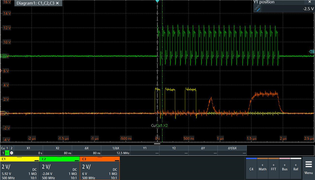

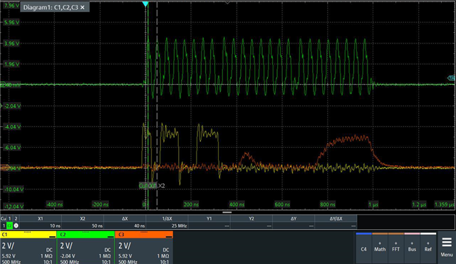

I use SPI interface to read LMX2820 register, I found the data is incorrect.
Then I use  oscilloscope to check its waveform as below:
1. Read addr 0x33 register, Green scope is 12.5M TP_SCK, yellow scope is TP_SDI, orange scope is TP_MUXOUT
2. Read addr 0x33 register ,Green scope is 25M TP_SCK, yellow scope is TP_SDI, orange scope is TP_MUXOUT
So, Can I do something cofigurations to uptimize the situation?
