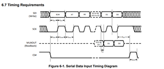

In the Figure 6-1 of the datasheet that is illustrated below, the SPI is defined (also in the text following the figure in the datasheet "Recommended SPI settings for this device are CPOL=0 and CPHA=0.". This means, like the figure below that the first edge of the SCLK after the CS# is a rising edge, and the clock pin when there are no SPI cycles performed is low. Also the Datas on SDI and SDO are sampled on the rising edge of the clock and "changed" on the falling edge.

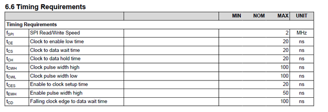

    If the 2 MHz is the right frequency, why about the Tcwh and Tcwl that are both expressed as max value of 100ns (this means 200ns of period so Max Frequency is 5MHz). I measure also the SCK frequency of the LMX1204 Eval. Board and that is equal to 125KHz.

    I have also a new question about the TCES. I interpret this time as the time between the falling edge of the CS and the first valid clock edge (for CPOL = 1, the first falling edge). In the Datasheet is reported the Max time 20ns, is possible that this can be the minimum time? On the Eval. board the time measured is circa 500ns. How much this time can be relevant in the correct programming sequency of the component? There is an interval (min-max) to respect?

  • With the exception of the first spec, these should all be min specs;  that's a pretty big datasheet blooper.
    These digital timing specs have some good margin in them and the way we typically test is run some digital patters for a go/no go test.  We typically don't do a breakpoint test where we find the limit where the part actually starts to fail.
    With 125 kHz write speed, it seems hard to blame this as a pure timing spec.
    For TCES, your interpretation is correct.
    Ok, perfect. It also need to be changed the min values of time. Since frequency is max 2MHz, the pulse widths of clock needs to be changed.

    Your symptom is also correct. Analyzing better the SPI trace of the LMX1204 eval board, we've noticed that the SPI number of SCK's are 24, that means if the data is 16 bit, 1 bit for R/W, this means that the address in 7 bits for a total of 24 clock cycles.
    In the Figure 6-1 of the datasheet is illustrated the SPI interface that is composed by 1 bit R/W, 8 bit Address and 16 bit Data, for a total of 25 SCK cycles.
    We also implement the CPOL = 1 and CPHA = 1 in order to maintain the same guideline of the Eval Board.
    Changing the Address from 8 bits to 7 bits we can program the device, that works fine and also allows me to readback the register values. So at the end, is correct with 7address bits and 1bit R/W + 16t bit Data & CPOL = 1 and CPHA = 1. I've put there a screenshot of the correct trama:

  • George,
    OK, another datasheet blooper ...
    The address is actually 7 bits, not 8, so the diagram is wrong.  There is a R/W bit.  So sometimes we are careless and consider the R/W part of the address, but it is not.  But it should be 24 bits.
    So the datasheet was telling you to send 25 bits and it sounds like you were doing this.  But by keeping Data high, it caused a happy coincidence as it canceled this unwanted address bit.  So it seems like the two issues in teh LMX1204 datasheet are:
    1. Specs swapped in the min/max column
    2. Timing diagram should show R/W bit + 7 address bits, not 8 address bits.
