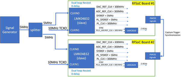

Hi ,
I am currently using the below setup to achieve the multi-board multi-tile synchronization.
I am using a splitter to feed 5 MHz into both RFSoC Boards as shown below.  I have used the registers for LMK04832 and program onto both RFSoC boards but could not get the Multi-board clock synchronized.  Attached is the tcs file and registers.
1) Checked Status_LD1 pin and it seems that PLL1 is not locked. Why?
2) What configurations do we set to make sure that the LMK04832 takes only external clock to achieve MB MTS ? The external clock 5MHz will feed into CLKIN0 of the LMK04832 slave boards.

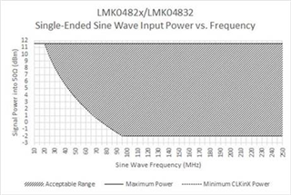

  • Hi Jan,
    As I have mentioned over earlier email, as CLKin0 is configured in single ended configuration and if you are feeding the external sinewave signal as 5MHz to these pins, you should apply higher amplitude signal to meet input slew rate requirement. Below is the graph for acceptable input range over the frequency for sinewave input.
    If you are using the RF splitter, I would be suggesting to keep Sig Gen output power setting as 20dBm or so. Hence, the CLKin0 input will see sufficient sine wave amplitude level and meet slew rate requirements.
    PLL1 may not be locking due to the lower slew rate at input signal.
    Attached config file looks good, except, use the SYSREF_MUX setting for pulser mode and generate the SYSREF pulses for divider reset once the PLLs are locked.
