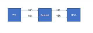

We have used DS110DF410 retimer in one of the design and currently, we are doing S-parameters simulation (frequency Domain) for the below circuitry.
And S-parameter file llp48_pkg.s4p which is shared by the TI team is having below port naming conventions. Could you please let me know how to map this s-parameter model pin to our circuit?.
