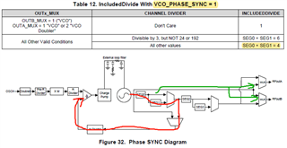

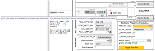

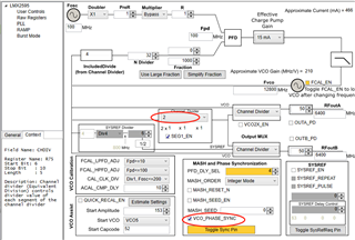

Will SEG1_EN should be set to 0 or 1, when the following conditions:
but from datasheet SEG1_EN should be set to 0.
And manual description is inconsistent with TICS software description.
Thanks!

Thank you very much for the prompt reply, I still have a question:
Referring to the settings in the above figure and the figure below, how do the outputs of different LMX2595 achieve multi-chip synchronization
Hi Applo,
There are some re-clocking circuitries to achieve phase synchronization. The design is TI proprietary, we won't detail it in the datasheet.
