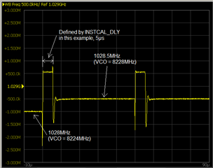

Use TICs Pro to simulate instant calibration and use an oscilloscope to grab the low pulse width of TP_LD. TICs Pro follows the flow from this link(https://e2e.ti.com/support/clock-timing-group/clock-and-timing/f/clock-timing-forum/1188044/lmx2820-lmx2820-not-locking-with-instant-calibration/4498140?tisearch=e2e-sitesearch&keymatch=LMX2820%2520instant%2520calibration.#4498140)
In VCO and VCO Divider mode, the frequency hopping lock time for instant calibration is between 6-7us. However, according to the manual, the instant calibration time is 2.5us and in VCO Doubler mode, the frequency hopping lock time is 60-70us.
1) Why is the lock time for instant calibration more than 5us? Is the settling time included?
2) Why is the lock time significantly being longer with the output doubler?

  • Hi Cherry,
    See a test example below.
    In this example, the lock time is less than 10µs. This lock time can be further reduced with a smaller INSTCAL_DLY setting.
    No matter if the output frequency is direct VCO output or with doubler output, the switching time with instant calibration will be similar.
