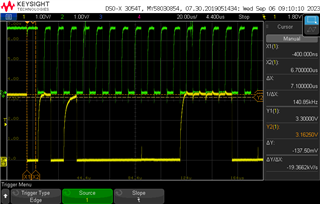

In the I2C i have MCU as master, FPGA and 3 more components as slaves. I have 5kohm pull up resistors. In the SDA i see somtimes diffrent rise times when the MCU send the address to the FPGA.
Yellow - SDA
Green - SCL
good SDA pulse:
Not a good SDA pulse: Slow rise time and less high level of the SDA (this is the second pulse - the pulse after the picture above):
Why is that?
Thank you

    Please provide more information - is the MCU driving the I2C bus directly and if so, what MCU?
    If there is a buffer between the MCU and the I2C and if so, what is the device?
    And in the second 'scope capture you show with the slower rise-time, is that signal originating from the MCU, or one of the devices on the I2C bus?

    The MCU driving the I2C directly without buffer. only 33ohm resistors in the start of the line and in the end of the line. and 5kohm pull up in the middle of the line.
    The MCU is of silicon Labs: EFR32BG24A010F1024IM48-B
    Yes i think the signals in the pictures are originating from the MCU since i see the address of the FPGA (MCU sends the address of the FPGA). The address of the FPGA is 1010000
    Zoom out pictures:
    Thank you
