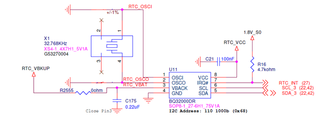

Hi, Support Team

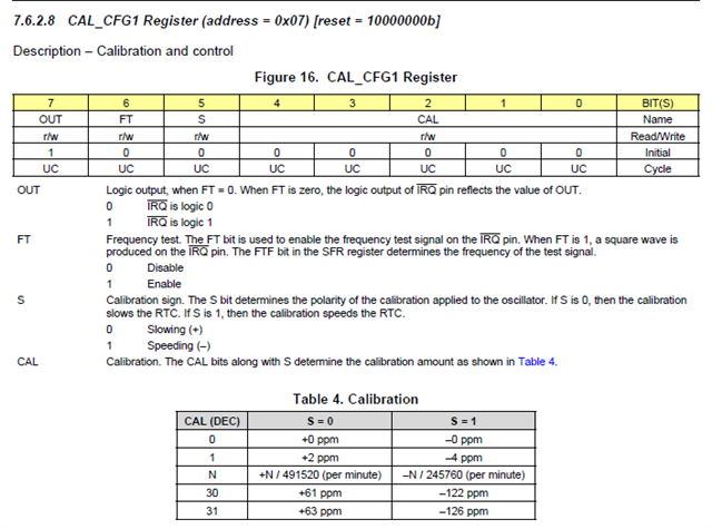

Could we adjust the registers according to our requirement?
Schematic as below chart:
if any suggestion, Please advise me.

Can you explain a bit more about the issues you're having with the CAL_CFG1 register? There's a description of the calibration process in this thread: https://e2e.ti.com/support/clock-timing-group/clock-and-timing/f/clock-timing-forum/703635/bq32002-bq32002-improper-time#pi320966=1

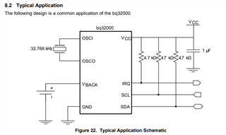

Also looking at your schematic, the crystal shouldn't need to be connected to GND. See this example schematic from the datasheet:
