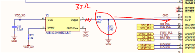

I am using TICSPro to generate the raw registers which I then load into the chip over SPI. This all seems to work fine. I have the STATUS0_SEL set to "DPPL Loss of Lock (LOFL). It is set to high, which means the DPLLis not locked. I have pasted my schematic in case anything seems off. I cannot seem to be able to insert my TICSPro file.
I am able to output a 10MHz tone on out2 and out3, however, it does not seem to be locked to GPS 1PPS. If there's anything that jumps out that is wrong, I would appreciate the help.

  • I did a quick look at your schematic - I don't see any big issues... however I would have suggested placing a 33 ohm series resistor at output as a source termination for the LVCMOS output.  Then have the voltage divider close to the IC.  I imagine the distances you have probably this doesn't cause an issue.
    -- Also, about your locking issue.  Did you try staring with the 1-PPS Default configuration?
    Is your input validated?
    Note that 1-PPS phase detector should be enabled along with validation timer, all other validations off.  The ppm error between input and XO must be small, even with the max 63 setting on 1-PPS phase detector.

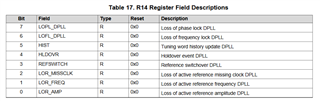

  • I do not know what you mean by starting with the 1-PPS default configuration.
    However, I did read registers R14, R167, and R411.
    R14 I read the following: 0xD0. It seems the DPLL doesn't exit from a holdover event as the DPLL doesn't lock to frequency or phase.
    When I read register R167 I get the following: 0x00
    When I read register R411 I get the following: 0x00
    I'm not sure how to interpret as the user programming guide doesn't have any information about those registers.

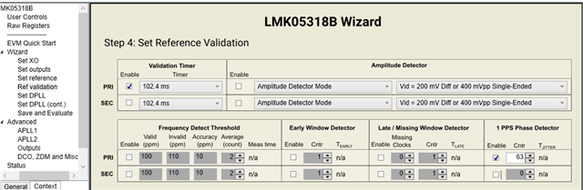

    1. The DPLL won't lock unless the reference gets validated (PRIREFVAL_STAT, R411[2]). Getting this bit to set is the first step in the debug.If it's clear, the device will remain in holdover and the outputs stay locked to the XO input.
    2. To elaborate on Timothy's comment with the reference vallidation:
      When configuring a 1-PPS input, only the 1-PPS Phase Detector and Validation Timer can be enabled for reference validation.
      The phase detector sets the XO accuracy through the PRIREF_PH_VALID_THR register. The counter has a maximum value of 63.
      If XO exceeds required accuracy, then the 1-PPS reference will not be detected.

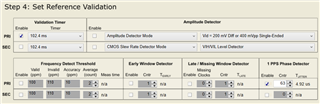

    The new XO has arrived. It is 12.8MHz with ±2.5ppm frequency stability.
    https://www.digikey.com/en/products/detail/jauch-quartz/O-12-80-JT32C-A-K-3-3-LF/8107804
    I changed the .tcs file because I added the new XO: 3463.lmk.tcs
    I read registers R13, R14, R167, and R411 to get the following:
    R13: 0x1D
    R14: 0xC0
    R167: 0x2
    R411: 0x8
    To answer your initial question, here is the setting of the reference:
    Any help would be greatly appreciated.
  • Hi Javier,
    Please try with this .tcs file. I've set OUT2/3 to 10 MHz CMOS. The DPLL settings are configured for 1-PPS PRIREF using a 12.8 MHz XO input.
    LMK5B12204_DPLL LBW=0.01 Hz_XO=12.8 MHz_PRIREF=1PPS_OUT23=10 MHz_Oct 3 2023.tcs
    Jennifer
  • Looks like we are onto something here!
    Reading the same registers we have the following:
    R13: 0x0
    R14: 0xC0
    R167: 0x1
    R411: 0x4
    Looks like now the reference is being validated. However, I am still not getting a successful lock as indicated by R14 reads.

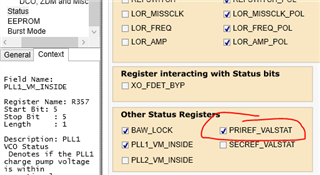

  • I forgot to mention. You have the the status_sel to DPLL R Divider by 2:
    I have those status's set to LEDs, and the LEDs toggle from high to low. Remaining high for one second before going low. Also, remaining low for one second before going high.
    Hope that helps diagnose the problem.
  • Hi Javier,
    1. After loading the .tcs, please hit "soft-reset".
    2. Are you able to route the STATUS pins to a scope? If the DPLL R and FB divider signals are phase aligned, then the DPLL is locked and in that case, we need to modify the LOPL/LOFL settings. Please confirm on the scope first.
    3. It can take several minutes and up to an hour for LOPL to report unlocked.
    Jennifer
