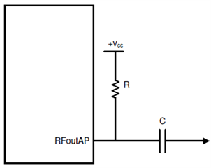

When the LMX2615-SP powers up, what is the state of the RFOUT outputs (pulled high, high Z?)
The concern is that the RFOUT is driving the input of an ADC (such as the ADC12DJ5200RF) CLK+/- prior to the ADC being powered up and exceeding the ABS max of the part. The ADC would power-up a few msec after the LMX2615 for instance.
  • Hi Steve,
