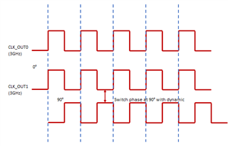

Customer generate 6GHz CLK with LMK04832 by the below methodology.
  1. Shift phase with half CLK against reference CLK.
  2. Shift phase dynamically between same phase and shifted phase with half CLK.
Regarding the above inquiry, is it possible with LMK04832 Dynamic Digital Delay ?

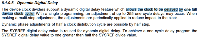

  • Hello Michiaki,
    If using dynamic digital delay, then the minimum delay you can do is by half a VCO cycle (note that you need to use the half step feature for this); therefore, if the VCO frequency is a multiple of the reference frequency, then the phases can be adjusted dynamically. However, to better help you/corroborate this, please tell me more about your system, your goals with your delays/why you need to delay your outputs, and the exact frequencies you're working with. If you have a .tcs file, please also attach it. Thanks!

    For example to understand easily, in case of CLKout at 3GHz, customer can select VCO frequency = 3GHz, reference frequency = 250MHz with half step function using Dynamic Digital Delay for the dynamic phase shift at 90° ?

    I want to clarify, are trying to achieve a 180 degree phase shift or 90 degree phase shift? Your diagram shows a 180 degree phase shift (refer to diagram below):
    This assumption is correct if you meant 180 degrees instead of 90 degrees and the phase shift is done tot he 3-GHz signal. Basically, this is the correct statement: "...in case of CLKout at 3GHz, customer can select VCO frequency = 3GHz, reference frequency = 250MHz, and set another CLKout with half step function using Dynamic Digital Delay for the dynamic phase shift of 180° from the 3-GHZ CLKout"

  • Hi Andrea,
    Regarding your point it out, your understanding is correct.
    Customer would like to generate pseudo 6GHz with interleaved operation by phase shift at 180 degree. Therefore, they just would like to make sure if LMK04832 can support to adjust phase by half period.

  • Hello Michiaki,
    The LMK04832 can support adjust phase by a half period, so the LMK04832 should still be applicable to their application.
    Could you share the data of accuracy for duty of VCO CLK ?
    When half-step is enabled, duty-cycle correction is also enabled. Meaning, the accuracy of the duty cycle is taken into account, and therefore, by turning on duty cycle correction, the part will behave with a 50% duty cycle. More information about duty cycle correction on p. 51 of the data sheet.

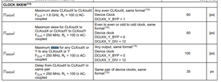

  • Hello Michiaki,
    I just got a reply back from my team. Basically the tolerance of the 50% duty cycle uses the falling edge of the clock, and because you will be using the VCO internal to the LMK04832 to generate this clock, the 50% duty cycle will be exact to the extent that the VCO is a good approximation of a simple harmonic oscillator, making the sine wave generated by the VCO free of extra harmonics and other noise.
    However, this tolerance will also be dependent in the relationship/delay between the two 180 degree phase-shifted outputs of the chip. Inherently the device has a 60-ps typical skew between different CLKouts, which will add a delay between the two clocks. Therefore, if for your system requirements this extra 60-ps delay between the outputs is acceptable, then you can use half step on one output with a divide-by-1 setup (do not set the any outputs in bypass) and no half step on the other output with a divid-by-1 setup. Let me know if you need further clarification.

  • Hi Andrea,
    Let me summarize my understanding based on your answer.
    Regarding the tolerance, accuracy of duty of VCO CLK, there is no tolerance, really accurate of duty of VCO CLK at 50% duty cycle.
    Customer will use two 180 degree phase-shifted outputs. In that case, customer need to care of the skew between different CLKouts. It means the skew will cause 60ps delay between outputs.
    Is my understanding correct ?
    Thank you and best regards,
    Michiaki Tanii
  • Hello Michiaki,
    That is correct. Just note that the skew will be around ~60ps. I've tested this is lab and I saw a delay between outputs of around 50-60ps.
