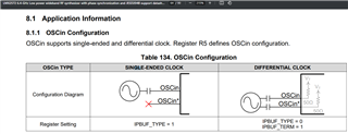

I just want to confirm the technical solution with you since you are the experts.
Due to ppm stability ( +-25 ppm ) I have decided to go with LMK6210-100M, this device have HCSL output freq.
From my understanding the HCSL levels will work fine into LMX2572, I have 100nF capatictors between LMX2572 and LMK6210.
LMK6210-100M output VoH 660mV to 900mV, Vcross 250..475mV
LMX2572 Fosc differential Vin 0.15..1V
Differential config in registers:
set
IPBUF_TYPE=0
IPBUF_TERM=1
Please let me know what you think.
