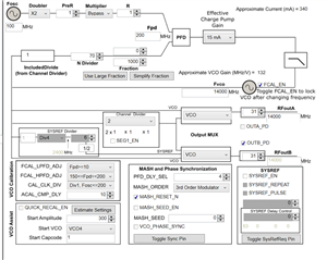

  • I tried to look at it again today, it seems that in channel divider output mode it outputs 7GHz, but when I switched to VCO output I do not see the 14GHz I expect to see. Here is my setting on TICS Pro. It was tested after a clean power cycle (LMX2594 powered on first, then the usb of the reference pro pluged in, then I go to default mode of the TICS pro, which allowed me to see 7GHz. Then I only changed channel divider to VCO. The software recommends me to turn off SEG1_EN so I did, but makes no difference.)

    Try again with the following procedure:
    1. open TICS Pro and select Default Configuration
    1. Vcc power up the EVM
    2. provide a valid reference clock
    3. USB Communications --> Write All Registers (it should output 7GHz, LD LED will ON. If not, uncheck - check the FCAL_EN bit to calibration the VCO again)
    4. Change the Output MUX setting to VCO output (you should see 14GHz signal)
  • This is exactly what I did and I do not see 14GHz signal.
