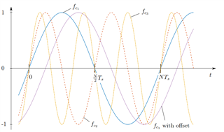

Hello, we're aiming to get multiple carrier sine-frequencies on multiple channel, but these meet every N*Ts time again. Here is a graph, what exactly the goal is:

Is the phase-coherent behavior guaranteed, if we use multiple TRF3765s, that have different frequencies on different channels like shown before in the picture?
Can you still guarantee the phase alignment for such a setup?

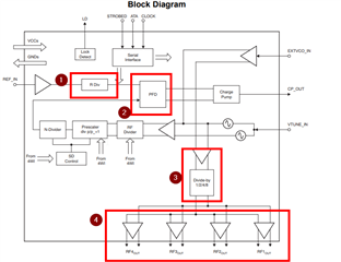

    I was going to make the same suggestion for the TRF3765 where you keep the R-divider = 1 (marker 1) to ensure the PFD (marker 2) going to the various TRF3765 are the same phase to ensure the output phase of the PLL to be the same (marker 3). However, you will also need to ensure the output divider to be set to /1 only as setting to other divider without a synchronization circuit will result in varying phase through the divider logic. The last variable is the output driver (4) which may have temperature and phase variations from one device to another.

    On the TRF3765, there is no option to synchronize the output dividers across multiple devices.  In your case, it looks like the frequencies are binary multiples of an initial frequency.   If the frequency is always in the fundamental range (i.e. 2.4 - 4.8 GHz), then this is not an issue and the (same) output channel between devices will be properly synced.  In this scenario it would only allow frequencies of 2.4 and 4.8 GHz.  Further note the output of each of the four channels are not phase synced to each other; there is a fixed delay between each output.

    The output divider is not "in the loop".  The PLL loop does have its dividers (i.e. R-div and N-div) for properly locking the reference frequency to the desired VCO (fundamental) frequency.  Once locked, the output dividers provide additional range outside the fundamental VCO range to get to lower frequencies.  These output dividers need to be synced to ensure the phase is properly aligned to multiple outputs.  If you are not using the output dividers (i.e. only using the VCO within its fundamental range), then I agree that no "syncing" is required.  Yes, the LMX2572 does have a sync feature so that can also be a suitable choice.
