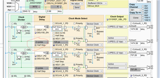

I also want to ask some question about the half step delay. the 2 cycle is standing for the sysref clock will be delayed for 2 clocks? and this delay refers to what clock? refer to itself or the other output clock?

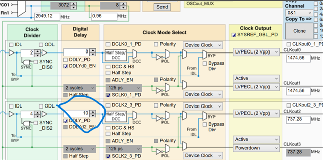

Hi Conner, for the DDLYd2_EN,the minimum value can be set is 8, why i can turn down it to 4?and for the half delay. this cycle stand for a whole cycle of the output clock?

The DDLY code has a minimum value of 8 and a max value of 1023. The actual delay measurement equals the DDLY code multiplied by the period of the clock distribution frequency (seen at the top of the "Clock outputs" page).
For this config I'll use a VCO1 frequency of 3000 MHz driven from CLKin1 = 200MHz and power down PLL1:
For a 90° phase shift at 6.25MHz, the delay between outputs should be 40 ns. Since delay = DDLY Code / Clock distribution frequency: DDLY Code = 40 ns * 3000 MHz = 120. So this means that there needs to be a difference of 120 in the DDLY code between 2 outputs to have a delay of 40 ns between them. I set the DDLY code for the 100 MHz output to be 130, and 10 for the 6.25 MHz output.

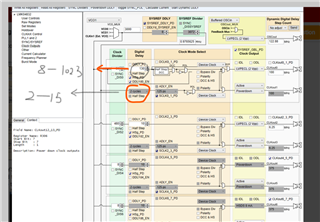

thanks for your reply, i have know how to set it and i want to know for the ch0 and ch1,the two have different delay configuration, can you tell why? for the ch0,it is delay can be set from 8-1023 but for the ch1,it only delay can only be 2-15 cycle.what the difference between them?

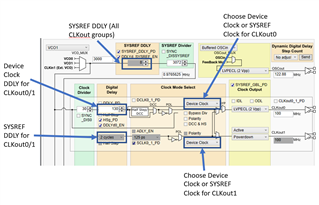

Hi Eric,
The DDLY code that ranges from 8-1023 is for both CLKout0 and CLKout1 if the device clock is selected. The 2nd box that ranges from 2-15 is for both CLKout0 and CLKout1 if the SYSREF clock is selected, and would be adding to the SYSREF delay at the top of the page. Essentially the device clock DDLY works independently from the SYSREF DDLY. Hopefully this picture makes things a little more clear
