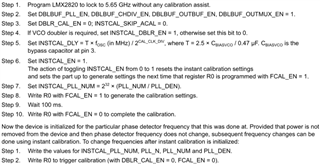

     We are using   LMX2820 in our boards .During the LMX2820 initialization process, it occasionally can not be locked. Below is register configuration details.
In addition, when setting frequencies of 5650MHz and 5800MHz,6200MHz, the waiting time is 30ms, because if it is less than 20ms, the LMX2820 basically cannot be locked.

/*wait 10ms to allow internal LDO Power up */
write 0x00, 0x647000
/*instc al init*/
write 0x02, 0x81F400
write 0x01, 0x57a300
write 0x26, 0xFFFF00
write 0x27, 0xFFFF00
/*wait 30m s set 5650MHz */
write 0x2A, 0x400000
write 0x2B, 0x000100
write 0x24, 0x001C00
write 0x2C, 0x400000
write 0x2D, 0x000100
write 0x00, 0x642000
write 0x00, 0x643000
/*wait 30 ms set 5800MHz */
write 0x2A, 0x000000
write 0x2B, 0x000000
write 0x24, 0x001D00
write 0x2C, 0x000000
write 0x2D, 0x000000
/*wait 30 ms set 6200MHz */
write 0x24, 0x001F00
