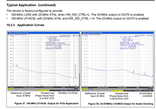

    2. The default operation is for an XTAL input of 25 MHz and an output of 100 MHz on OUT1 through OUT4 (there is a mistake in the datasheet, default is LP-HCSL on both pages):

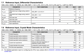

    3. The PRIREF pins can be used with an external 100 MHz XO - the datasheet criteria must be met:
