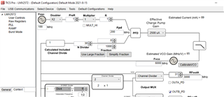

    We also have TICSpro GUI which can be used to control our EVM, the GUI updates corresponding values as you edit certain parameters:

  • Hi Vicente,
    There is one more thing i would like to know is MASH order and PFD_DLY_SEL which ar ebeing used for Minimum N Divider Restrictions, i was going through the data sheet but unable to understand the proper working of it i have used the TICSpro GUI also for this purpose but i am still unable to understand. Hop you can help.
    Thanks. :)
  • Hi Vanshaj,
    What are you asking here exactly?
    For each VCO frequency range, their is a corresponding minimum N divider value and PFD_DLY_SEL for each mash order.
    Mash is is a sigma-delta modulator that gives you control over the the fractional divider with mash order being the order you want the fractional divider at.
    Vicente
