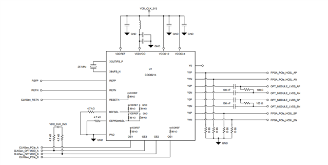

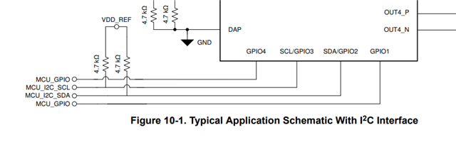

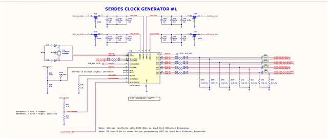

We using CDCI6214 as pcie clock support. Now we found we can't find IIC address(0x77) of it, and can get the clock of CDCI6214(100Mhz) in TDA4VM EVM. So we want to know:
1 is CDCI6214 neet a driver? There is no driver for it in SDK of TDA4VM, but it work OK. So it can work on no driver mode?

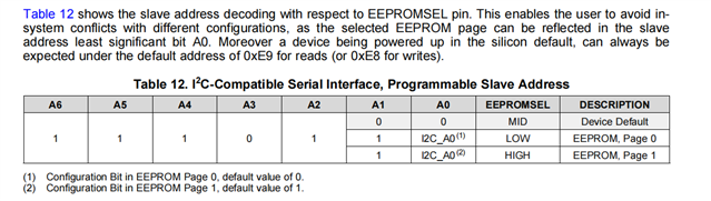

2 EEPROMSEL PIN of CDCI6214 SET LOW in SK-TDA4VM, but we can't found I2C addr(0x77). We try to set EEPROMSEL pullup to 3.3V, can get I2C addr 0x76. It is conflict with CDCI6214 manual?

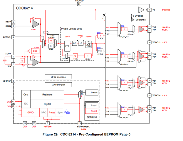

3 On our custom TDA4VM board, we set EEPROMSEL PIN of CDCI6214 Low using page0 as shown below. When OE2 and OE3 pullup to high, all out clocks are OK; when OE2 and OE3 hang/pull down, Y2P/N and Y3P/N no output. Why?
