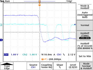

I'm using the Mute pin for pulse modulation.
The time spec for Mute/Unmute is 200nSec.
When I set Mute pin to 3.3V the signal is muted in less than 200nSec which is good.
However, when changing it back to Mute = 0V, for frequencies over 11.2GHz it's unmuted in less than 200nSec which is ok.
However, for frequencies lower than 11.1GHz it takes about 3uSec to reach 90% of power.
