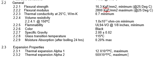

I'm looking for the mold compound CTE for your EP plastic used on the following devices. I'd also like to review the qualification data available for these to see if they would be suitable for use in our environment or if we need to find an alternate .
LMK04832MPAPSEP
TRF0208ARPVRNSP
