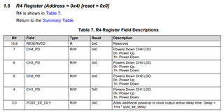

Part Number: CDCE6214
When CDCE6213 is set as serial interface mode, OE1 input can't be used.
In this case, the same function can realize by setting a register bit field.
What register has the same function?

Oba,
R4 contains power-down bits for each individual output channel:
The outputs can alternatively be muted individually with the corresponding CHx_MUTE bits:
The POWERDOWN bit (R0[1]) can be used to power down the PLL and all outputs:
