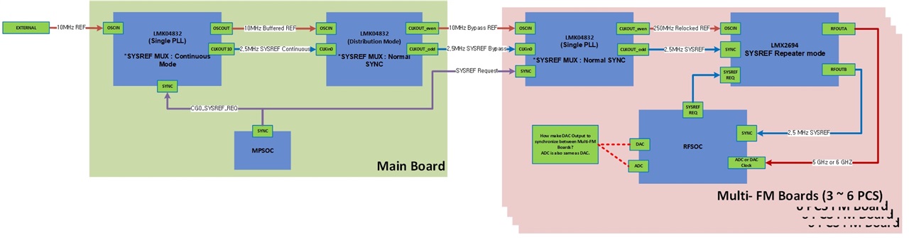

I want to make the fixed deterministic phase between clock outputs in all of the multi-boards.
First, please see the following my multi-boards configuration.
Unfortunately, in my testing experience, the phase relationship between the output clocks of FM boards is always changed on each power-up.
So, In order to get all of these multi-boards to work well, I have to do an alignment of the phase of the FM boards at every power up.
As you know, it's really unreasonable to adjust the phase at every time.
I would like to know how to get a fixed phase and synchronous phase between all FM boards, even after power off and on.
Please check the resistor map and programming sequence to achieve the synchronous divider of Device Clock Output as follows.

Programming Sequence tor achieving the Sync of divider.
** 2.5MHz SYSREF is continuously delivered to the clkin0 from other LMK04832 on the main board.
(1) Set from 0x14311 to 0x14391 (SYSREF CLR)
(2) Set from 0x1443F to 0x14400 (SYNC_DISx and SYNC_DISSYSREF)
(3) Toggle the SYNC signal for at least the duration of one cycle of the 2.5MHz SYSREF.
(4) Set from 0x14400 to 0x1443F (SYNC_DISx and SYNC_DISSYSREF)
(5) Set from 0x14391 to 0x14311 (SYSREF CLR)
** It seems that difference phase between sysref and device clock is changed after doing this sequence.
In my opinion, if each of the dividers is reset simultaneously to the SYSREF signal - rising edge? or falling edge? - it's always right to have a fixed phase relationship between SYSREF and the device clock, isn't it?
But it's always changed the phase difference between SYSREF and the device clock randomly after doing every this programming sequence.
I'm waiting for your kind reply.

  • Dear Andrea,
    Thank you for your prompt reply.
    I'm sorry, but would you tell me more information about SYNC dividers?
    I want to make a synchronized clock between three boards like FM#1, FM#2, FM#3 in the following diagram.
    Please see the following questions.
    (1) Could you tell me if tdFM1, tdFM2 and tdFM3 are going to become the same delay after the SYNC divider sequence?
    (2) On my side, it doesn't matter if tdFM1 to tdFM3 doesn't have the same delays(phases), as long as their respective delays are fixed and stable.
          But, in my testing experience, unfortunately delays of the tdFM1, tdFM2, tdFM3 are always varied with doing every SYNC dividers sequence.
          So, i had no choice but to do the calibration to synchronize the clocks on the modem side after every power on cycles.
          It's needed the time and man power to calibrate this every times with several equipment.
    Please one more check our configuration, resistor map, and Sync divider sequence whether it is good or not.
    And if possible, please give us your feedback.
    Thank you,

  • Hello Han,
    What delay are you trying to represent with tdFM#? Are this the outputs, is each a different LMK04832 board/chip? The outputs of a singular chip/board will be phase aligned +- 60ps (skew spec in the datasheet) after following the sequence. Are you not seeing your outputs aligned after following the above sequence?
    Let me know about the answer above. In the meantime, I'll test this in lab and review everything else and get back to you by the end of the week. If possible a .tcs file would be even better than the register map attached.
    Andrea
  • Hello Han,
    Looked at everything in more detail and it looks like you did not fully setup your 0-delay properly. Set 0x13F to 21. You need to change the source of the PLL2_NCLK_MUX to FB Mux so you can ensure your input (SYSREF signal) is being phase synchronized to your outputs when you are completing the synchronization sequence.
    To clarify, first you need to synchronize your outputs to your SYSREF using 0-delay mode and then changing your SYSREF to be re-clocked by your distribution path. Below I have listed the different steps to make sure you are following the correct sequence to synchronize your boards:
    1. Need to setup 0-delay mode (as explained above) to ensure your outputs are synchronized to your input. This way you'll have synchronized inputs and outputs. For your case, you need cascaded 0-delay mode so the input relationship is done via OSCin.
    2. You need to synchronize your outputs. Make sure SYSREF_PD is turned on, SYNC_MODE is set to 0 and SYSREF_MUX is set to 0 too. Did not see this detail in your sequence above. I have included the correct sequence below for your reference.

    3. Set up SYSREF (or the input to CLKin0, which is SYSREF in your case) to be re-clocked from the VCO distribution path. Do this by setting SYMC_MODE = 0 and SYSREF_MUX = 0.
