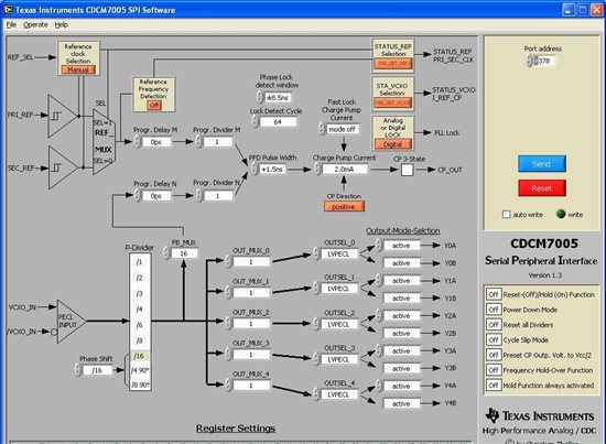

Having the M divider = N divider and P divider = 1 as requirement: what happens if the pri_ref = 6.25 MHz and VCXO = 100 MHz?
The matter is that 6.25 MHz / M is different from 100 MHz / (N * 1): keeping in mind than 1 <= M = N <= 1024 is a required condition!
This condition cannot be simulated with the TI PLL Sim tool version 1.2!
Is this condition a nominal working condition of the device?
From what I've read, it looks more like both frequency should be equal at the input of the PFD block! Is that correct?
