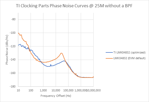

  • Hello Jaeheung,
    You would have to simulate the first PLL first, save that waveform, and then input that waveform when simulating the second PLL. However, tying to your second question, PLLatinum Sim already considers the VCXO being inputted into the second PLL so you can do your analysis on the second PLL. Note that's assuming the VCXO you are using is the same or better phase noise curve than the one I previously attached.
    The loop filter can significantly reduce the phase noise, below is an example when maximizing the loop filter's phase noise and increase the phase detector frequency as much as possible (note that higher phase detector frequency/lower N-divider value results in better phase noise).

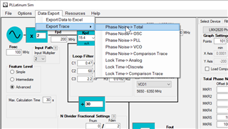

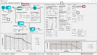

    1) Do the PLL1 simulation. Select LMK04832-SP as your device and then PLL1 (ignore selection of PLL2 in pciture below):
    You need to input the phase noise data of the reference signal you are using by clicking "Load Data" as shown below. Note that I highlighted where to find the user guide and where to find the '?' which will provide more help and guidance:
    The resulting phase noise curve simulation (bottom left corner of GUI), will assume you are using a Crystek VCXO like the one on the LMK04832-SPEVM-CVAL.
    2) After you get the simulation (bottom left corner of the GUI), you need to export that data:
    3) Then, go back to "Select Device" page, select PLL2:
    ...and reload the exported data back into the PLLatinum Sim as done in Step #2. The resulting phase noise curve after this second step would be your estimate.
    Here is an example of the .txt that PLLatinum Sim will accept as the input (left column are the frequency offsets, x-axis, and right column are the phase noise value, y-axis):
