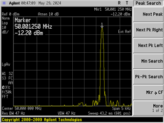

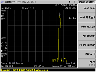

Hi Jennifer,
If the output is set to 312.5MHZ + 25ppm, will it affect jitter?
Hailiang

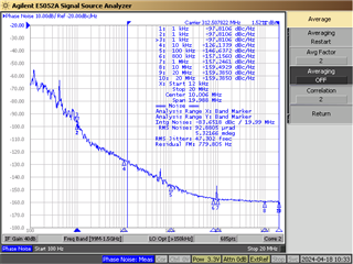

Hi Hailiang,

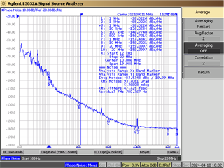

The jitter is still within spec. Please see example plots comparing between 0 and + 25ppm offset on 312.5MHz outputs. Note that the DPLL is locked in both of these pictures. The XO input is sourced from a signal generator (SMB100A).
0ppm:
25ppm:
Jennifer

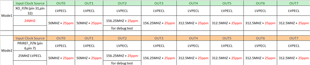

Hi Jennifer,
Thanks for your support.

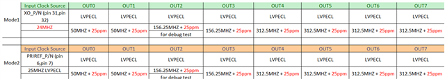

Please help provide the LMK05318BRGZR profile for 312.5MHZ + 25ppm according to the table below.
Mode1 |
Input Clock Source |
OUT0 |
OUT1 |
OUT2 |
OUT3 |
OUT4 |
OUT5 |
OUT6 |
OUT7 |
XO_P/N (pin 31,pin 32) |
LVPECL |
LVPECL |
LVPECL |
LVPECL |
LVPECL |
LVPECL |
LVPECL |
LVPECL |
24MHZ |
50MHZ |
50MHZ |
156.25MHZ |
156.25MHZ |
312.5MHZ + 25ppm |
312.5MHZ + 25ppm |
312.5MHZ + 25ppm |
312.5MHZ + 25ppm |
for debug test |
Mode2 |
OUT0 |
OUT1 |
OUT2 |
OUT3 |
OUT4 |
OUT5 |
OUT6 |
OUT7 |
PRIREF_P/N (pin 6,pin 7) |
LVPECL |
LVPECL |
LVPECL |
LVPECL |
LVPECL |
LVPECL |
LVPECL |
LVPECL |
25MHZ LVPECL |
50MHZ |
50MHZ |
156.25MHZ |
156.25MHZ |
312.5MHZ + 25ppm |
312.5MHZ + 25ppm |
312.5MHZ + 25ppm |
312.5MHZ + 25ppm |
for debug test |

What is the jitter spec for the 50MHz and 156.25MHz outputs?
The LMK05318B does not support individual ppm offset setting. This means that if VCO1 is set to 2500MHz +25ppm, then all outputs from APLL1/VCO1 will also have the +25ppm offset.
If you want to output both 50MHz/156.25MHz and the 312.5MHz+25ppm, then the 50MHz/156.25MHz outputs will have to come from APLL2/VCO2.
Jennifer

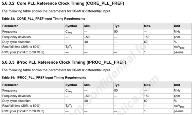

Hi Jennifer,

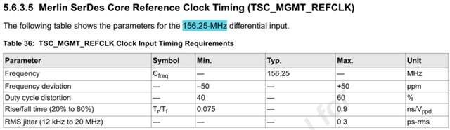

Noted. Please set 50MHz and 156.25MHz + 25ppm too.
Bellow is the jitter spec for the 50MHz and 156.25MHz outputs
Hailiang

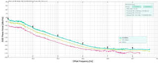

Hi Hailiang,
Since 50MHz and 156.25MHz are also +25ppm, all output clocks are from the same BAW VCO 2500MHz. I'll collect the phase noise and share with you.
-Riley
Hi Hailang,
Here is phase noise of output clocks. All clocks have jitter meet this spec.
Model 1: Free-run with XO 24MHz:
50MHz + 25ppm:
156.25MHz + 25ppm:
312.5MHz + 25ppm:
Model 2: DPLL lock with 25MHz input:
50MHz + 25ppm:
156.25MHz + 25ppm:
312.5MHz + 25ppm:
-Riley

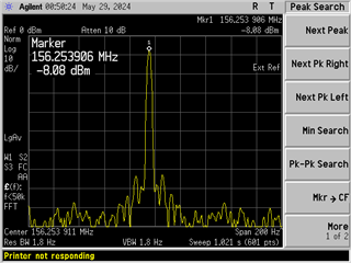

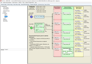

Hi Hailiang,
This config uses 24MHz XO and 25MHz input. PLL1 is tuned with +25ppm so all outputs are +25ppm.
24MHz XO, 25MHz input, OUTx + 25ppm.tcs
-Riley
Hi Riley,
Using .tcs file you shared to test, we found OUT3 is 50MHz, OUT4 and OUT5 are 156MHz, which does not match the customer requirements. Attach again.
Please help to check the config and update.
Hailiang

Hi Hailiang,
I don't have problem with Riley's configuration.
Power up --> Load the configuration file
Hi Noel, Riley,
The output seems does not match the customer requirement.
GUI:
Customer requirement:
I update the configuration by changing the channel dividers. But pls confirm will this affect output performance?
