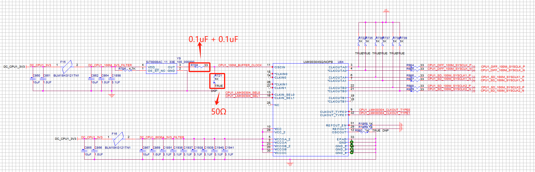

LMK00304: Is there any way to adjust the duty cycle to 50%?
Part Number: LMK00304
When using the LMK00304 chip to output three 100MHz differential clocks, after measurement, the duty cycle of all output clocks has reached 60%. What is the reason for this? Is there any way to adjust the duty cycle to 50%?
The following three figures correspond to the three output clocks.
