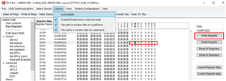

  • I have found, by fiddling with raw bits, that if I set R252 bit 6 to a zero then the behavior is more like we would expect.
    This bit is described as DPLL_ZDM_NDIV_RST_DIS. What does it do?
    I do not require ZDM as I no longer need to sync the 1PPS of OUT7 to the 1PPS reference. How do I control ZDM mode in the GUI V1.7.7.2?
    I can see PLL1_NUM_STAT jump around (+/-300000) from its nominal value when the 1PPS on PRIREF is first applied, then stay at a fixed number when 1PPS is removed, then jump around again when 1PPS is reapplied, but only by +/-1.
    Why is the DPLL adjusting the APLL1 by so much on the first time it sees 1PPS, and so little the second time it sees 1PPS?
    Have you managed to duplicate this on the TI evaluation board?

    I've reloaded the config and noted on ZDM bits are enabled while PLLx_Px_SYNC_EN = 0. You should be able to disable ZDM through Raw Registers page on GUI by writing direct 0/1 to the bits, R252.
    You might want to disable Auto Update so the bit isn't updated while writing. After all bits are written, do Write Register to update.
