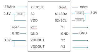

    As a supplement, inputclock is stable and you can see our circuit conditions by below figure.

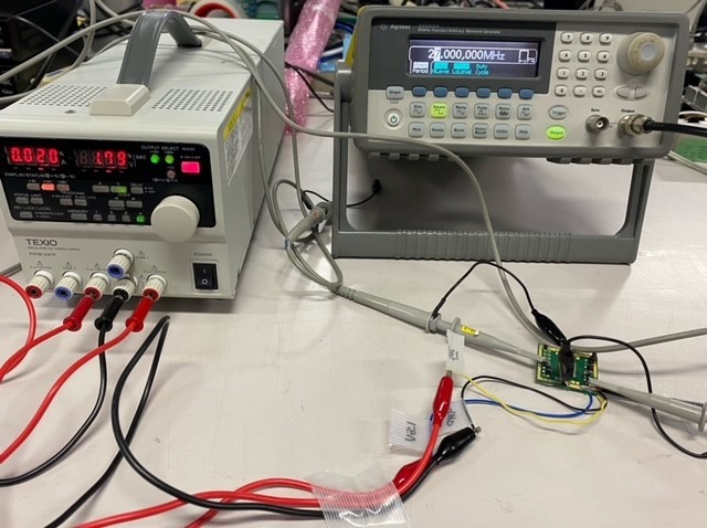

    This problem was reproduced by using a pulse generator instead of the FPGA as the clock input.
    The power supply uses a stabilized power supply to supply 3.3V/1.8V.
    The method is to supply the device with 3.3V/1.8V with a regulated power supply.
    Then, after 30 seconds, the pulse generator supplies clock at 27MHz (1.8V).
    If this problem does not occur, turn off the stabilized power supply and pulse generator output again and try the above method again.
    We was able to reproduce this in about 20 times, so please try repeating it 20 to 50 times.
    We also confirmed that the input waveform when the problem occurred met the timing requirements and was unchanged from normal case.
    We have not been able to confirm the VDD/VDDOUT waveforms, but we have reproduced it using the method above, so I assume that VDD/VDDOUT is not related to this problem.

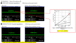

  • Hello,Team,
    more additional information,

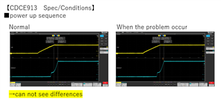

    We was able to confirm the VDD/VDDOUT waveform during the problem occur using a probe.
    Photos of the results are attached.
    Regarding the rising waveform, there is no difference between normal and problem occur conditions.
    Regarding the current value, VDD was 21 mArms when normal and 12.7 mArms when abnormal, confirming the difference.
    No big difference was observed in VDDOUT.
    However, ripples have been confirmed when both VDD/VDDOUT are abnormal.
    Additionally, we have confirmed that when an abnormality occurs, lowering VDD from 1.8V lowers the output frequency, and raising it from 1.8V increases the output frequency.
    In normal, the output frequency does not change even if the VDD voltage is changed during normal operation.

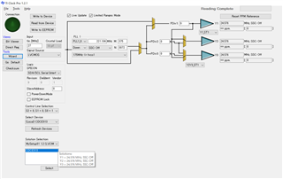

    The PLL is used at fvco=221.184MHz with the current register settings, and as shown in Figure 1 of the specifications, I think the current value during normal operation is appropriate.
    I have also attached the CLOCLPRO screen for setting this register for reference.
    Thank you for your support

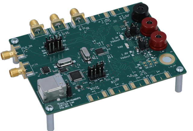

    Also, are you using the CDCE913 EVM? The EVM is what we are verifying this on, but if you can send information or a schematic about the PCB board it may help identify the issue further. For now we are trying to get to the root cause of this, but it is difficult due to being unable to replicate the problem.
    CDCE913Setup.TXT

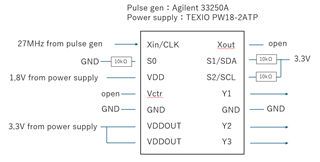

    Sorry, the circuit diagram I provided was incorrect.
    before: S0=0(pullUP), AFTER: S0=0(pulldown)
    We haven't tested it with EVM.
    As shown in the attached photo, the board using the pulse generator is mounted on a universal board.
    A schematic diagram and photos are attached.

  • Is the PCB you are using CDCE913PERF-EVM?

    Please be patient with us because will be some delay on further testing. We are using the CDCE913PERF-EVM, the configuration file is generated directly from the ClocksPro output, you can try loading it into the software to see if the config is the same as well. It is odd that the register is different.
    Are you able to pull the S0 pin high (Enabled) instead of low (3-state) and see if it is ok? That may fix the issue, otherwise we will need more testing.
    Andrew
  • Are you able to pull the S0 pin high (Enabled) instead of low (3-state) and see if it is ok? That may fix the issue, otherwise we will need more testing.
    →With our register settings, I think Y2Y3 is enabled when S0=LOW.
    If I'm wrong, please let me know.
