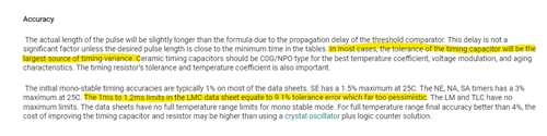

The following is the timing accuracy listed in the datasheet,
For example, it is 1.1ms (Typ) at Vs=5V,
Is this 1.1ms (maximum variation 1.2ms) regardless of the operating frequency?
Or did you mean that it varies by a percentage (1.0 to 1.2㎳ range with a ±9% percentage) depending on the frequency?
or did you mean that it varied proportionally (1.0-1.2㎳ range ±9%) with frequency?
