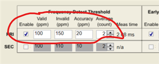

I am using the LMK05318B on a design and have been running into an odd issue. It seems when the device first powers on it is working fine and when I read the status page, all registers point to the device is locked.
When I issued a soft reset through the Gui, I found that the device would lose lock and required a hard reset to lock again. Then issuing a soft reset, I would get the same behavior. After some debugging I turned to the input monitor curious if I had an issue there. When I changed a value I caught that the TIC's Pro Gui was writing to register R220 which according to the register page is reserved. Funny enough, if I set R220 with the same value, I never have an issue and the PLL always reports lock even with a soft reset.
Can you comment on what the function of R220 is? The original value was read as "0x00DC 7A" and the gui modified it to "0x00DC 78".
