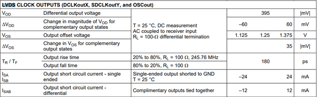

sir,
by default LVDS mode is there but we are getting 180mV only ,what could be the issue? Please let me know!!
Thanks In advance
Venkatesh,
I just turned on a LMK04828EVM in our lab, and was seeing the expected LVDS power level, in my case ~ 375 mV single ended and ~ 860 mV differential measurement, which checks out with the datasheet expectation.
I did my measurement by connecting the P and N terminals to the oscilloscope without a termination resistor between. With an oscilloscope that has a 50 ohm termination per connection. How were you measuring the output signal?
