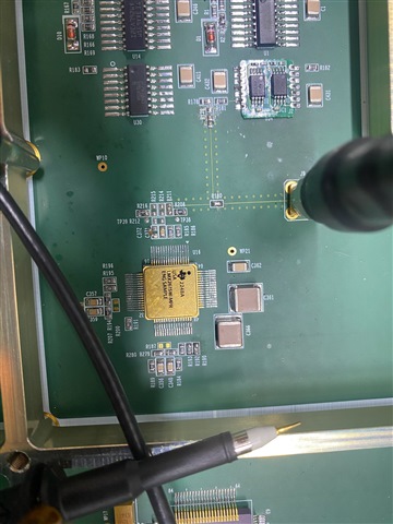

  • Hello Vicente
    No, we made a development board.
  • If you try loading the default config, can you achieve lock?
    Vicente
  • Hi Vicente
    We have an unlocked state from the pin MUXout.
    We have a value of '11' Unlocked (Fvco High) from the register R110 rb_LD_VTUNE.
    However, as I mentioned, your load file for the reference clock of 10.23MHz is locked.
    Regardless of the lock status, the output is the same.
    Moreover, even when setting a reset, making all register values '0', the same pattern is outputted.
     Is there any way to create the normal RFout?
    Can this be regarded as a broken chipset?
    RFout A
    RFout B
  • Hi Jaeheung,
    Can you provide a copy of your schematic so I may review?
    Did the default mode I showed in my last reply (which utilizes a 100MHz reference clock for OSCin) cause the LMX2615-SP to lock?
    Vicente
  • Hi Vicente
    I already answered your question.
    We have an unlocked state from the pin MUXout from the default configuration.
    Moreover, the same pattern is outputted even when setting a reset, making all register values '0'.
    I attached the circuit design.
    We have now adopted the single-ended OSCin.
    We have already confirmed that the reference clock is normal.
  • Hi Jaeheung,
    Did you get the feedback from our local FAE?
  • Hi Jaeheung,
    As Noel mentioned we are not sure if you received feedback from local FAE.
    I wanted to ask some questions after reviewing your schematic.
    I see you have a differential 100Ohm resistor at OSCin pins but the text box says the input is single ended?
    If operating single ended - I wouldn't expect the 100 differential resistor and the unused input should be AC shorted to GND or i.e. capacitor followed by series 50 Ohm resistor to GND.
    In the default mode, MUXOUT_LD_SEL is set to Lock Detect not readback. Was this register changed after loading the default configuration to enable readback? What you describe of all registers being '0' sounds like a readback was attempted while MUXOUT_LD_SEL was set to Lock detect not readback.
    Can you please provide you start up sequence step by step including programming?
    Vicente
  • One more thing,
    I see there is an email thread ongoing,
    Noel commented on the output being incorrect.
    You can use either a resistive pull up for good impedance matching or an inductive pull up for higher output power at the cost of matching.
    I will screenclip Noel's reply where he show's the resistors from the schematic that should not be placed & R188 should be swapped to 0Ohm.
    Vicente
  • Hi Vicente
    We revised the circuit of the outputs according to the comments.
    Now we have a normal output.
    Thanks a lot.
