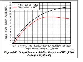

1) How to configure/interface PLL (P/N: LMX2582RHAT) and Buffer (P/N: LMX1214) and voltage compatibility for the same.

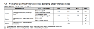

2) If one output of Buffer to FPGA in LVDS mode then can we connect another output to ADC (P/N: ADC12D1800) as well ??? and will ADC sample clock will accept the same mode??

    1. Please note that LMX2582 has an open collector output which requires an external pull up/
    If we assume 3GHz RFout with a 50Ohm resistor pull up (for good impedance) we can expect about 8dBm of RF power.
    Output power is adjustable via register config. Also please note you can achieve higher output power utilizing an inductive pull up at the cost of matching.

    2. Yes the LMX1214 is a 1:4 buffer thus you can utilize any of the other outputs.
    According to the ADC DS, the sampling clock specs are as follow:
