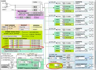

    If  CLKIN frequency is 1GHz, register R22 will definitely change because SYSREF_DELAY_DIV changes.The value of the R22 register at 1GHz is different from that at 5GHz.
    If I want the delay between LOGICLKOUT and LOGISYSREFOUT when CLKIN is 1GHz to be equal to that when CLKIN is 5GHz or 6GHz, Setting the same value in the red circle in the figure below does not make the LOGICLKOUT and LOGISYSREFOUT delays consistent at different frequencies. How can I configure this situation?

    After extensive investigation and research, I have been able to find that there is no such regularity. However, I should be careful to explain that it is not the result of a random phase difference. Given the high divide values of the LOGICLK and LOGICSYSREF signals, there are several possible phases (the number of possible phases is equal to the divide values). The delay between the signals was not deterministic, but their phase difference was
    Furthermore, in order to ensure that the delay value that you set is applied evenly on signals with different input frequencies, you need to use the equations found on page 25 of the datasheet ((2) and (3) in particular). You can scale up the delay applied when the input signal is 5 GHz to the appropriate delay for a 6 GHz signal by multiplying the number of steps by 6/5.
    Finally, in order to make sure the dividers are aligned, you need to use the SYSREFREQ pin to trigger a SYNC event. I did that by asserting SYSREFREQ_CLR high, waiting a few seconds, and de-asserting it. Using this technique and the calculations above, I was able to generate a set of signals that did not have an identical delay - but they did have an identical phase difference, and the difference in delay was a matter of picoseconds.

    Thank you for your reply. Can it be considered that when I set the input to 2GHz, in order to make the phase between LOGICLKOUT and LOGISYSREFOUT consistent with that in the case of 5GHz input, I only need to adjust the step of 2GHz input to 2/5 of that in the case of 5GHz?
  • Hi Shijie,
    That is not exactly correct. Table 6-13 states that the SYSREF_DELAY_DIV value is 4 when the reference clock is between 1.6 and 3.2 GHz (it is 8 when the reference clock is between 3.2 and 6.4 GHz). This would mean that, to adjust the step size from the 5 GHz input case to a 2 GHz input case, you would need to multiply your number of steps by 4/5.
    Michael

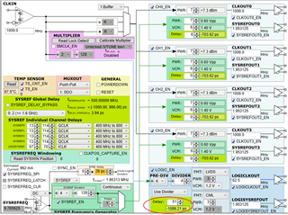

  • Hi Michael,
    If I set the delay to -1100ps at 5GHz, and the frequency becomes 2GHz, should I set the delay to -880ps or change the 114 in the red circle in the figure below to 91?
    Shijie
  • Hi Shijie,
    I am not certain of the answer to this question as I have not had time to take this into lab just yet. I will take it first thing tomorrow and let you know.
    Michael
  • Hi Shijie,
    In order to achieve the desired delay, you should increment the number of delay steps until the total delay is as close to -1100 ns as possible. As I mentioned before, this will ensure the desired phase difference. The resulting delay is the result of the frequencies of the new output signals.

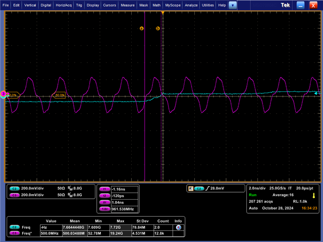

    I set the SYSREFREQ_CLR pin high, waited a few seconds, and then set it back to low. The scope shot can be seen below, where the delay is about -1100 ns.
    I then took that config and altered its input frequency to 2 GHz. I changed the frequency of LOGICLKOUT to 200 MHz and I did what I could to keep LOGICSYSREFOUT approximately the same (~9.76 MHz). I then increased the delay step value until it was as close to -1100 ns as possible.
    1204_2G.tcs
    The scope shot can once again be seen below, where the delay is approximately identical to what it was before (ignore the frequency measurement).
