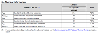

i need power dissipation details for this IC(LMX2820RTCT) or how to calculate power dissipation for this IC

Hi Sushmitha,
you can use TICS Pro (www.ti.com/.../TICSPRO-SW) to estimate the approximate current consumption at different configurations.
Hi Sushmitha,
If you were referring to power loss due to heat, all we have is below thermal information, which is available in the datasheet.
