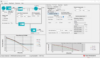

I have query regarding the PLLatinum simulation.
We are using LMK04828B with external VCXO option in the PLLatinum simulation and have come up with following values for both PLL1 and PLL2 and used the same the filter values connected at CPout1 and CPout2 as shown below.
But regarding PLL1 specifically, when I am loading the device with external VCXO, PLLatinum Sim loads with KVCO and VCOCap values as shown below (Charge pump current (Kpd), input and output frequencies are what we are using in our design currently so are correct).
Default KVCO value is 0.0025 MHz/V when loading up the PLLatinum Sim as above.
Default VCOCap value is 0pF when loading up the PLLatinum Sim as above.
But as we are using an external VCXO of which datasheet link I have mentioned it below:
CVHD-950
After looking into an external VCXO datasheet I have changed both VCO characteristics values (KVCO and VCOcap) as shown below.
I have converted 25ppm tuning sensitivity to Hz (from VCXO datasheet) and used that value in KVCO field and I thought VCOCap would be the output capacitance and used 15pF from the VCXO datasheet and placed it in VCOCap field below.
After using these values we have different loop filer 2nd order values to the one from default values and these values we have used in our design.
I have now following queries,
1. Do we just leave both KVCO and VCOCap values as it is when PLLatinum Sim first load up after selecting LMK04828 w/external VCXO?
2. How would we can get the VCOCap value?
3. What I have done to find the loop filter values by changing the KVCO and VCOCap values as shown in second screenshot is right or wrong? and what could I do to make it right?
  • You definitely have to set Kvco and VCOCap yourself, as this does affect the loop filter behavior - maybe for this case VCOCap isn't that important, but definitely Kvco is directly proportional to loop gain and must be configured properly.
    If we have a 76.8MHz VCXO, with 25ppm/V tuning sensitivity and 3.3V of adjustment range, this works out to 76.8MHz * 25ppm/V = 0.00192MHz/V, which appears to be the value you computed as well.
    15pF is listed under output specs, and is thus a representation of the maximum load the output can drive, not the capacitive load presented by the tuning port. If the manufacturer doesn't provide a good estimate of the tuning port voltage, it's reasonable to assume a few pF at most, usually on the low end. Since this is in parallel with C1, typically the effect of just leaving it at 0pF is minimal, and if you observe noticeable differences on-board, you can substitute the value of C1 for a slightly smaller capacitor to compensate; however, for low loop-bandwidth PLLs like this, the usual game is to design the loop filter such that C1 is large enough to render the VCOCap value insignificant by comparison.
    There's a poorly-documented option in PLLatinum Sim 1.6.7, under the "options" menu, labeled "Main Diagram Updates Performance Metrics" that needs to be disabled to prevent changes to Fpd and other settings from reverting the Kvco and VCOCap values to the defaults. The reason this default behavior exists is for devices with integrated VCOs, as the Kvco and VCOCap values may change depending on VCO core and frequency. I have asked, frequently, for this behavior to not be the default when external VCOs are used, but for now there's no mechanism in PLLatinum Sim to distinguish between an integrated VCO and a non-integrated VCO, so we have to do it this way. In other words, it's bewildering, but at least possible, to substitute your own values for VCO characteristics and have them stick through main diagram changes.
    A few other comments:
    • On the Phase Noise tab, in the upper left, under "Graph Settings", you can disable "autoscale axes" and set the x-axis minimum to 1Hz or 10Hz for a better representation of the close-in behavior. PLLatinum Sim was originally designed for our RF PLL product line, so the default axis scaling isn't the best choice for low-bandwidth loop filters.
    • The low Kpd and Gamma values, as well as the very high phase margin, are reducing the component values by a lot, which results in a loop filter that's mostly dominated by the PLL and filter component noise contributions. You could try something like Kpd = 0.35mA, phase margin = 60°, Gamma = 1, and still get something that's plenty stable, but gives back a lot more performance at the 1kHz offset and above.
