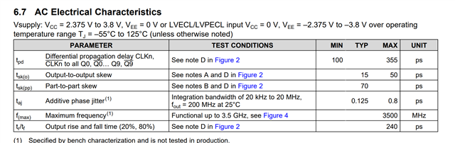

On CDCLVP111-SP, how does the variation in delay through the CDCLVP111-SP change with the temperature? How many ps/°C?

Sorry for the delay - refer to following attachment.
Maximum input-to-output (propagation) delay is 355ps and this is over PVT.

thank you for this first feedback. We are interested in the impact of the temperature ONLY (not Voltage or other parameters in this enveloppe). could you ?

I have completed the calculations to find that the CDCLVP111-SP has a maximum tpd shift of 0.767 ps/°C, and an average shift of 0.123 ps/°C.
