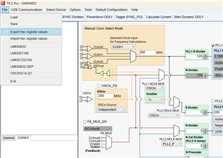

    Please note we have a tool, TICSpro, which is capable of doing this. You create you configuration file and can export as a hex file with all registers and their contents for use with your driver.

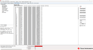

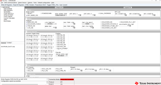

    We don't aware how to configure different configurations tabs in TICS Pro software to generate thee register space.

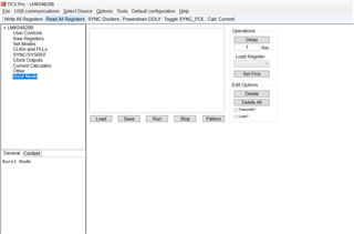

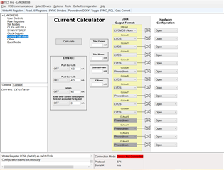

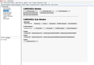

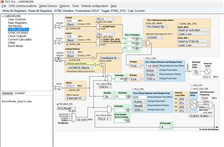

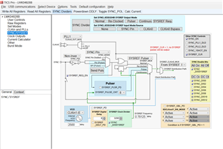

    We are attaching the screenshots of LMK04828 in TICS Pro Configurations tabs below.
    1) User controls
    2) Raw Registers
    3) Set Modes
    4) CLKin and PLLs
    5) SYNC/SYSREF
    6) Clock Outputs
    7) Current Calculator
    8) Other
    9) Burst Mode

  • Hi Vicente flores prado,
    And also, we actually have a register dump which we are currently using (for sampling rate 122.88 MHz), in vitis to program LMK04828.
    Now actually we have to change frequencies of some output clocks of LMK04828.
    We are attaching that register dump below.

    Could you please kindly let us know how to generate .tcs file, which can be able to load in TICS Pro Software in such a way that on top of that we can configure as per  our required frequencies and export HEX file.

    We do have an EVM user guide that goes into basics on configuring the device using TICSpro.
    https://www.ti.com/lit/ug/snau145b/snau145b.pdf?ts=1737482558047&ref_url=https%253A%252F%252Fwww.ti.com%252Ftool%252FLMK04828BEVM
    Please note that 48MHz for OSCIN to generate 100MHz & 125MHz outputs is a poor option in regards to phase noise performance.
    You would need a 24MHz PFD to generate a 3G VCO1 frequency which divides down to generate the output clocks you require.
    I highly suggest a 100MHz OSCIN clk instead as this would increase your PFD frequency which will help your PLL phase noise and will also reduce the N divider.
    There is a mathematic integer relationship that needs to be met between the ref clk & the VCO frequency.
    You don't need to edit the User controls page to generate output clocks rather it's their to configure registers depending on your application needs.
    Maybe you want to power down certain blocks for power saving purposes or you need holdover.
    The sync/sysref page doesn't need to be edited and ccan be left blank or you can power down the SYSREF engine. The "other" tab is meant to configure digital I/Os such as Lock detect, RESET, CLKin_SELx etc.

    Additionally, if you could guide us on how to generate a .tcs file from a .txt register dump configuration and how to load it into TICS Pro, it would be very helpful for us to review the current configurations.
