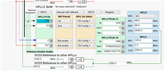

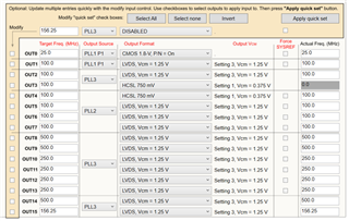

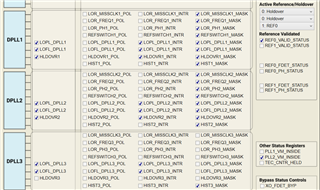

We are using the LMK5B33216 Evaluation board with the default TCXO (48MHz) with a single-ended 125 MHz input connected to IN0_P (J4). It looks like we have the DPLL settings setup to where it is choosing the right reference and not auto-reverting to the holdover setting. We are still seeing a message on the input page saying "No input selected" and the status page is showing loss of lock for DPLL3. Is there anything we are missing with our configuration? We are measuring an output on OUT0 at 25 MHz but we are not sure if we are somehow using the XO reference instead of the selected input clock reference.
Attached are some screenshots and the configuration file.
