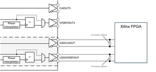

As shown in the attached configuration, the LOGICLKOUT of the LMX1204 is connected to the FPGA.

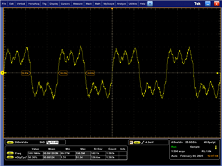

When observing the LOGICLKOUT waveform at the FPGA end, large ringing was observed.
-Set the output format of both LOGICLKOUT and LOGISYSREFOUT to LVDS.
-Connected to FPGA by DC coupling (direct connection).
-Install a 100Ω termination resistor on the FPGA side (receiving end).
When observing the LOGICLKOUT waveform at the FPGA end, ringing like the one shown below occurs.

If DC coupling is possible, is it sufficient to only use 100 Ω termination on the receiving side as shown in the attached diagram?

    Q2: The termination looks good and should be fine.

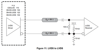

    Q1: The CLK outputs of the LMX1204 should not be DC coupled. The outputs of the LMX1204EVM are AC coupled due to the fact that most devices operating at RF frequencies are very sensitive and require the DC bias to be removed. AC coupling the LOGICLKOUT signal should be fine, so long as the frequency remains below the RF range. However, please try my suggestion in Q4 before removing the caps.
    I understand that AC coupling is recommended.
    In the case of AC coupling, I think an external circuit is necessary to match the VCM of the receiving side (FPGA, I/O standard is LVDS).
    Is the receiving side setting shown in the diagram below OK?
    #Quoted from TI document: SCAA059C "AC-Coupling Between Differential LVPECL, LVDS, HSTL, and CML"

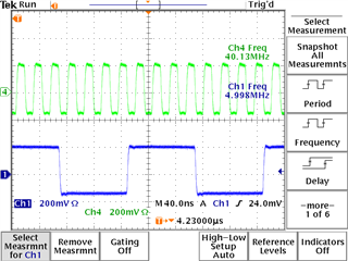

    You mentioned that there is no problem with the termination, but the waveform I sent you the other day with a large ringing was obtained with this connection (LVDS output).
    The measurement was taken with a differential probe at both ends of the 100Ω termination, so I do not think that the ringing is caused by an imbalance in the +/- signal.

    Q4: Considering that you got LVPECL to work with the AC coupling caps, I believe the ringing may be caused by inappropriate output termination. Based on the picture of your scope, it looked like you only input one signal. Would it be possible for you to input both the P and N pins of LOGICLKOUT to the scope and create a Math channel that subtracts one from the other? Otherwise, one of the outputs will have a 50 Ohm termination to GND, and the other will not, which could cause such problems in a closed-circuit driving format like LVDS.
    I used a differential probe for the measurement. Is it inappropriate to use a differential probe?

    I took your setup into lab and I believe I have recreated your issue! I was seeing the ringing that you saw when I set the pre-divide value to a value greater than 1 (i.e. 2 or 4) and bypassed the dividers.
    The pictures below document what the output of my LOGICLK looked like and at what settings.
    In the above image, I have configured the LOGICLK output dividers to output a frequency of 160 MHz with a pre-divide value of 1. When I change that value to 2, I get the scope shot below:
    So far, I had behavior as anticipated. However, when I changed the setting from "Use Divider" to "Bypass Divider" with the pre-divide value of 2, I saw the output below:
    When I changed the pre-divide value to 4, the ringing got even worse:
    When I changed the pre-divide value to 1, the ringing was reduced:
    I believe that in your setup, the ringing can be reduced by using the dividers (if you are not already) and by setting the pre-divider to 1, and using a larger divider value.

  • Hi Michael,
    I sent your suggestion, but Phenomenon was not improved.
    Could you please see attached file and advise?
    result0218.pdf
