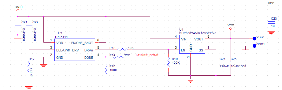

Please check the circuit
Part Number: TPL5111
Other Parts Discussed in Thread: TPL5110

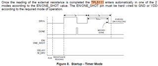

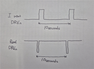

I want to operate tpl5111 every 10 seconds, but it operates in the opposite direction as shown in the picture.
Please check the circuit.
