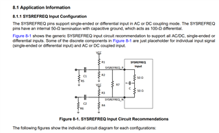

I am using the LMX1204 component on my new design and need to supply a signal in 1.2V LVDS common mode to the SYSREF_REQ pin. Can I rely on the internal 100-ohm termination provided internal by the component, or is an external termination required? If so, I would appreciate an example of how to implement this correctly.
