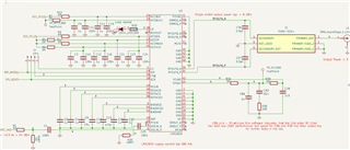

Recently I've designed a custom PCB containing 3 LMX2820 ICs, in order to simultaneously generate 3 output frequencies: 325, 650 and 1300 MHz. The reference signal (162.5 MH 7 dBm) is applied from external signal generator and is distributed via power splitter to 3 OSCin_P pins. I also have used TICS pro software with LMX2820EVM and USB2ANY in order to get a PLL set up (VCO, Dividers, Multipliers, Charge pump current, output power levels, etc.). Exported Register Maps for 123 registers have been implemented in the C code for the microcontroller, that drives LMX2820 via 3 independent SPI buses. My custom Hardware was missing couple things:
1. MUTE pin wasn't shorted to GND - I had to do it on PCBA. I also have set a PINMUTE_Pol active High.
2. RFOUTA_P and _N output signals requires AC Coupling 100nF capacitors - I forgot to add them to the design. I have cut the copper tracks and ripped of a piece of soldermask covering the traces and assembled required capacitors in series.
After performing a fix No.1 I was able to lock all the 3 PLL at the specified frequencies - proven using a spectrum analyzer.
RFOUTA_P and _N output signals are converted into single ended signal via balun TCM2-43X+ RF transformer (3dB instertion loss).
The main problem is the power level of the output signals (output signals, i.e. signals at the SMA output) 325 MHz -17.5 dBm, 650 MHz -20.1 dBm and 1300 MHz -23.2 dBm. I expect output signals to have power level between 6 and 7 dBm (bracket power has value 7 in TICS PRO). These output power levels were the same before and after performing a fix No. 2. Afterwards I have also  removed C26 and C27 0.5 pF capacitors to see if power levels of the output signals will improve. Unfortunately the power output levels were still the same.
I have performed a simple test: AC coupling capacitors from fix No.2 have been mounted vertically in order to open the RF transformer circuit. A 100 ohm termination resistor has been assembled to the capacitors from the other side. I've measured voltage on the resistor using wide band differential probe connected to spectrum analyzer. Results: -26 dBm Peak at 1300 MHz. This test ensured me, that the transformer circuit is not the problem and low power level must come from PLL IC's.
I see couple possible reasons: a) I have set up wrong register maps. b) PLL IC's may be damaged because of missing AC coupling capacitors during first few tests before ading fix No. 2.
I send the register maps for 325, 650 and 1300 MHz in the attachement - IT Support please answer if you find any problem with register values. I also send a screen containing LMX2820 circuit - Maybe a problem hides somewhere in the schematic.
