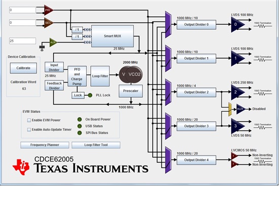

I used the CDCE62005 Controller GUI v1.4.4" generate a register value. I only used an auxilary input crystal of 25MHz to get two 100MHz, one 250MHz and two 50MHz output
respectively. But I don't quite sure about the value I got from the GUI. Can you help me with these values? And how to configue the loop filter?
And the registers' value are as follows:

    thank you for the interest in our device. I checked your register setting and I found out that you are using the external loop filter, which usually is not strickly needed for XTAL input case. I defined my register setting in order to get the same output frequencies and the lock condition as well. Please find them attached.
    In order to get the lock condition I had to tune the loop filter. On the GUI you can use the Loop Filter Tool. Two parameters are important: the Loop Bandwidth and the Phase Margin. In case of XTAL input you can set a wide loopbandwidth. The Phase Margin should be in the range 60 to 70 degree. You can change these parameter by tuning C1, R2,C2, R3 and C3 values. You will see a direct impact on the output jitter performance.

    you need to configure the internal loop filter to get the lock condition, after you get the right output frequencies by using the Frequency Planner. The values of C1, R2, C2, R3 and C3 depend on the required loop bandwidth. For an XTAL input case we usually suggest a loop bandwidth in the range 100k-1MHz. I set a Loop Badnwidth of 460kHz and Phase Margin of 62 degree. In this case: C1=11.5p, R2=9k, C2=461p, R3=5k and C3=8p. After pushing the Calibrate button, the Lock condition was achieved.
    I am still checking what PORTS means. I guess it is somehow related to the programming interface.I will come back to you about this topic as soon as I have better info.
