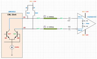

I'm using the LMK04832 in Dual Loop Mode.
1. PLL1 Reference is 100MHz
2. PLL2 Reference is 156.25MHz External VCXO [Fed into OSCin]
3. PLL1 R = 16, PLL1 N = 25
4. Goal is run PLL2's Internal VCO [VCO1] @ 1.611328125GHz
5. PLL2 R = 8, PLL2 Pre-N = 5, PLL2 N = 33
I want to Configure the {2} Output Clocks as CML 32mA.
Question-1: Can these Output Clocks, running at 1.611328125GHz, configured as CML 32mA, come from "Even" Clock Output Pins or "Odd" Clock Output Pins?

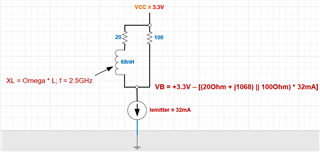

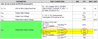

B). AC Termination Analysis
1. Vod = 550mV to 765mV [DC Biased is 68nH to 20Ohm to Vcc, AC-Coupled with 100Ohm Termination at the Load-Side]
Z {Inductor} @ 0GHz = j * Omega * L = j * 2 * Pi * 0GHz * 68nH = j0 Ohms [@ D.C.]
Z {Inductor} @ 2.5GHz = j * Omega * L = j * 2 * Pi * 2.5GHz * 68nH = j1068 Ohms [@ 2.5GHz]
When QB = "Off", QA = "On"
  • VA = +3.3V
  • 32mA flows through 20Ohm + 68nH Inductor which is in Parallel with the Load [100Ohms] setting VB = 3.3V - [(20Ohm + J1068) || 100Ohm) * (32mA)]
I must be making some sort of Math Error, because when I try to solve this equation, I don't get Vod = 765mV [IDL = 1] or Vod = 550mV [ODL = 1]
Question-2: Could you Outline the Math Steps to get VB = 3.3V - [(20Ohm + j1068) || 100Ohm] *32mA = 2.535V [Vod = 765mV] or VB = 3.3V - [(20Ohm + j1068) || 100Ohm] *32mA = 2.75V [Vod = 550mV]?
  • Hi Dallas,
    Using CML as an output format requires bypass mode, meaning the output dividers cannot be used. Furthermore, only the even clock output pins may output using CML. As a result, 3.22265625 GHz may be output, but only by CLKout0/2/4...
    I will keep working to verify this calculation for you. For now, I can tell you that I am not certain that the effective load in parallel with the RL combination is 100 Ohms - at least not for the IDL = 1 case. For the ODL = 1 case, that should be close to the effective load.

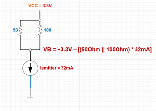

  • Question: Have you been able to determine Vod with 20Ohms in Series with 68nH Pulled Up to +3.3V, AC-Coupled to 100Ohm?
    1. For the DC Termination Case, the "Math" works [50Ohm Pulled Up to +3.3V in Parallel with 100Ohms]:
    A). DC bias is 50Ohm pull up to Vcc {3.3V}, AC-Coupled to RL = 100Ohm
    When QB = "On", QA = "Off"
    • VA = +3.3V
    • 32mA flows through 50Ohm Resistor [External Rb] in "Parallel" with Load [Load = 100Ohm] setting VB = 3.3V - [(50Ohm || 100Ohm) * (32mA)] = 2.233V
    Vod = 1.0667V [This "Agrees" with the Data Sheet Vod = 1070mV]
    2. For the AC Termination Case [@ 2.5GHz]
    If I replace the 50Ohm Pull-Up with 20Ohm in Series with 68nH, I get:
