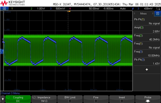

This is a clean indication that the input 10 MHz is not in sync with the 40.28 MHz signal. Here is a snapshot from the scope including both the 10 MHz and the 40.28 MHz clocks.

    When you are generating this output, is the Status_LD LED light turning on? The output being measured is not an integer multiple of the reference frequency, so they will look unsynchronized on the scope. However, as long as the LED indicated lock status for both PLLs is on, then the phases are synchronized.

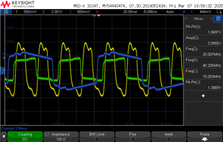

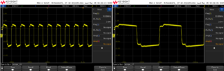

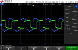

    Today, I managed to redo the experiment again on another ZCU111 board and indeed I can see the output clock (CLKout5) is in sync with the reference 10 MHz clock from the SynthHD clock generator. I set the frequency of CLKout5 to 10 and 20 MHz respectively to make it an integer multiple of the reference clock per your suggestion. Here are the snapshots:
    The third clock in the scope is a clock generated by the SynthHD to output a pure 40 MHz, and as you can see all the clocks are in sync.
    On the ZCU111 board, the STATUD_LD pin is connected to the DS45 LED which shows the locking status. In my configuration, the LD outputs the default settings, which is PLL1 and PLL2 DLD. So even for the 40.28 MHz, the LED indicates they are phase synchronized. I removed the 10 MHz reference clock and I could see the STATUS_LD switching off.
