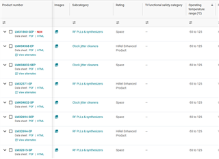

Hi Maharajan ,
We have space or HiRel grade devices that support -55 degC to 125 degC. Can you please specify the frequency plan as well as the output phase noise/jitter requirements?
The full list can be found in the ti.com Clocking portfolio when sorting by temperature.
https://www.ti.com/clocks-timing/products.html#sort=1192;desc&
Jennifer

Hi Maharajan,
The LMK04832-SEP is a jitter cleaner for military applications.
Please let me know your thoughts on the above proposal.
Jennifer
