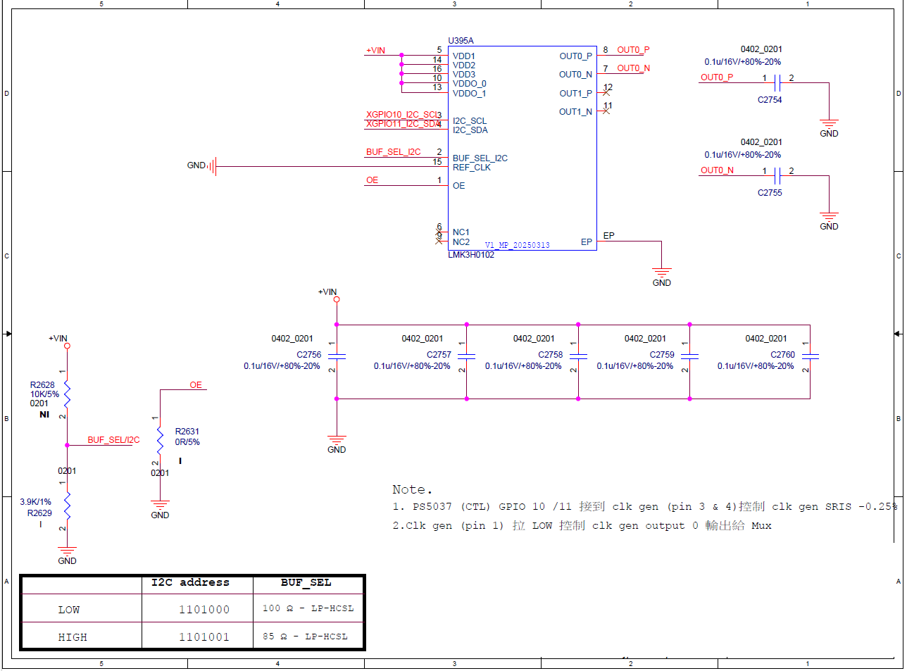

Part Number: LMK3H0102
Would you please help us for schematic review. thanks!

Jeff,
The capacitors for OUT0_P and OUT0_N should not be present.

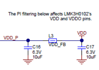

For best performance, I recommend isolating VDD and VDDO_x using ferrite beads.
I typically recommend using a 1k resistor to connect REF_CTRL to GND rather than directly shorting to GND as a best practice.
The 85-Ohm LP-HCSL is only for OTP mode, in I2C mode the output format is 100MHz LP-HCSL for the V33/V18 configurations regardless of the Pin 2 state.
Ensure that pull-up resistors are present for the I2C connections.

Hi Kadeem,
Do you have ferrite bead suggetion part number or spec can provide to us? thanks!
Jeff
Jeff,
On the evaluation module we use Wurth Elektronik 742792656.
