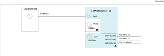

Hello experts,
I am looking for support for the configurations of my RSOCs in my project. in particular I would like to configure my LMK04832 into a 10MHz. all the clocks go to the kintex ultrascale FPGA into LVDS format. The output required are the following:
  1. 2x 156.25Mhz for the GTH banks.
  2. 2x 125Mhz
  3. 250Mhz x 1 DDR4 clocks
  4. 100Mhz x 3
we can choose any external VCXO. using your tools the configurations recommended was the following.
the only clocks that mandatorily require PLL2 from the 10MHz are the 125MHhz and 250Mhz clocks.

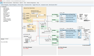

however when we tried to create the configurations with tics pro we failed to reproduce this configurations created on your website.
can you please advise?
